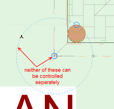

Is there a way to permanently turn off the circle guide lines?
2022-09-07 03:30 AM
Not just the circle snap guide lines.
In Work Environment you can turn off incremental angle guides.
Otherwise it is all snap guide lines on or off.
2022-09-07 10:44 AM
Thanks Barry, I can't see the point of them (circle ones) and they just get in the way.
Is there a way to disable the automatic user origin then, as that seems to make circle guide lines everywhere.
Also I have never got an email notification on any my Posts on this new format. The settings are all set to default and most talk about subscriptions. What the hell is a subscription about? Perhaps another word for Posts? Do I have to subscribe somehow to my own posts? Showing my age and ignorance LOL.
2022-09-07 11:12 AM
Neither the snap guide for the node or the snap guide circles can be controlled other than all on or all off.
However you can delay the time it takes for them to automatically appear.
In the Work Environment ...
You can then use the keyboard shortcuts to force them to appear so you don't have to wait for the automatic time allowed.
So set it it for 2 or 5 seconds or longer.
2 seconds is probably not too long to wait for the automatic placement (I am happy with 1 second).
If you don't want to wait but you do want the guides, use the keyboard shortcuts.
