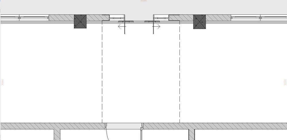

In my model I have two slabs with different materials to simulate the difference between two pavement floors. The problem is that in a plan view the coincident line between them is represented with a dashed line instead of a continuos line.
How can I fix that without creat space between them?

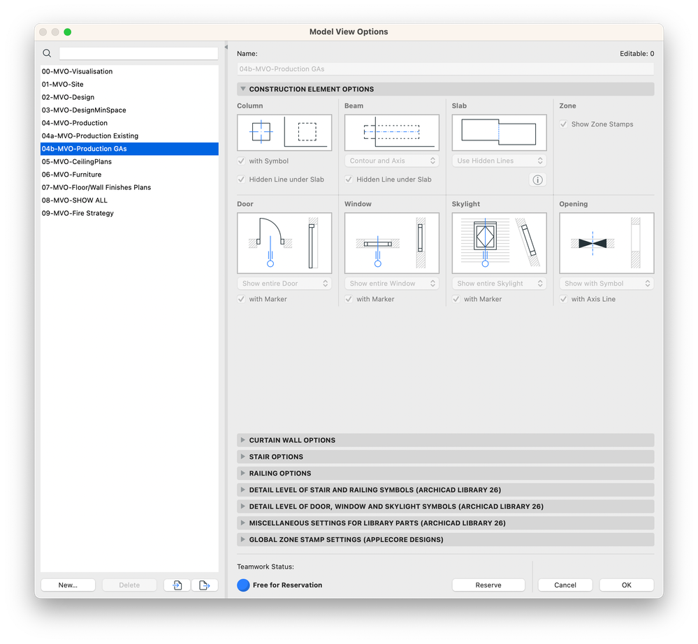

This can be changed in the Model View Options under Construction Elements.
2022-12-05 04:22 PM
