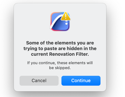

I am trying to paste some elements from one plan file to another plan file and I get this. It doesn't tell how to turn off this filter.

2023-05-09 02:49 PM
James:
Check which Reno Filters (Existing, Demo, New) are set to Show in the original file and make sure this same filters are visible in the second file.

2023-05-09 03:02 PM
Hi David,
The file Im copying from is set to Project Completion. The file I'm copying to doesn't have that option.

2023-05-09 03:23 PM
James:
Here is the Reno Filter Options:
The Reno Filters are like Layer Combinations, they can differ between files, so if you may want to set up a matching Option for the second file.

2023-06-15 02:05 PM
If you set up a RenovationFilter that shows all objects regardless of RenovationStatus - then you should be able to paste anything into your active view since they are not hidden by the settings of the RenovationFilter.
