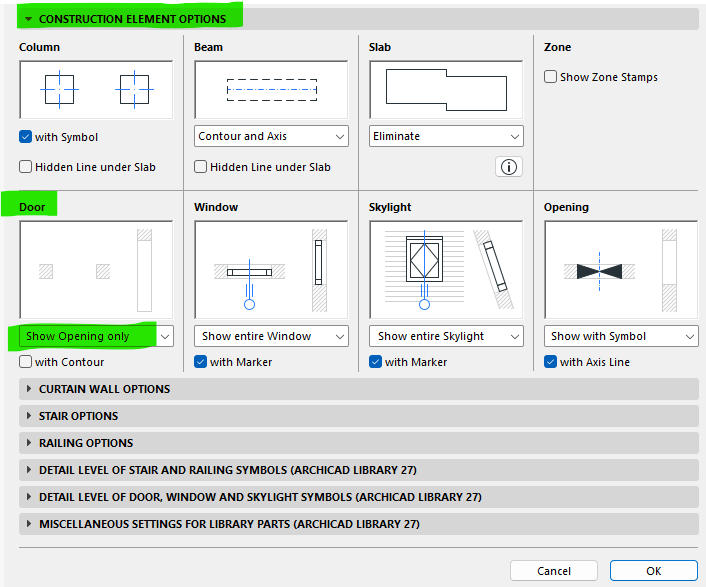

Mac platform. I'm making an electrical plan, and the doors aren't showing up. I know its something to do with the renovation filter, but I don't know how to fix it

Either renovation filter or you might want to check model view options

I checked the model view options, and the doors still don't show up
CosminF
The doors don't show up as in the wall is continuous? If so, you might want to check floor plane cut plane height.

@mukster
When you say 'electrical plan' are you changing the 'Floor Plan Cut Plane' height in your view settings?
Or are you doing a '3D document from floor plan' ?
My electrical plans are simply my floor plan with different layers.
All other settings I keep the same.
