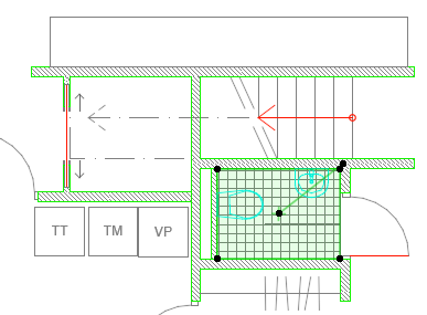

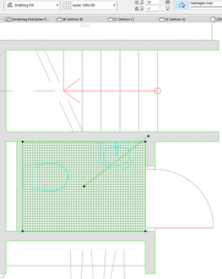

I have an issue with fills and the scaling & rotation of them. They dont respond to scale and orientation changes. On top of that, they are the same pixel-size when i zoom in and out. I cant find any settings that affect how they appear on screen.
Though if i publish a layout to PDF, it does read whatever input i set in my view even though invisible in the viewport.
Renovationstatus "show all original"
Overides "none"
Modelview  - tried them all
Close up: Tile is 100mmx100mm and notice the orientation of the tile not following my input
Futher away:

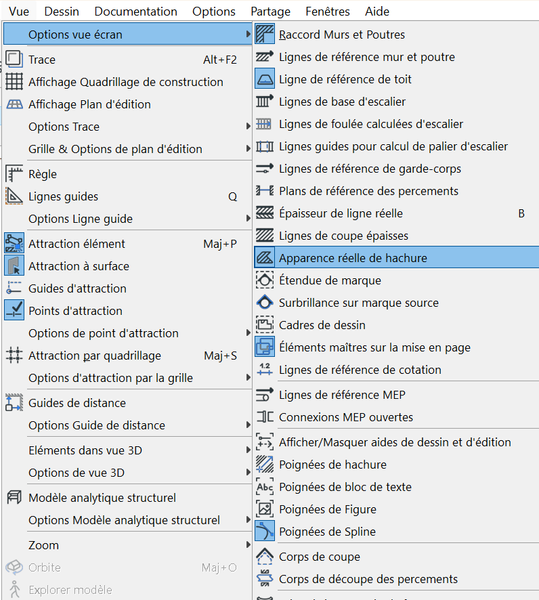

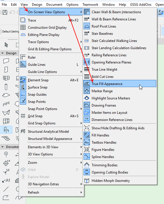

Do you have vectorial hatching switched off in your on-screen view settings?

Given the different scaling between images 1 and 2, is the fill scaling setting correct?
