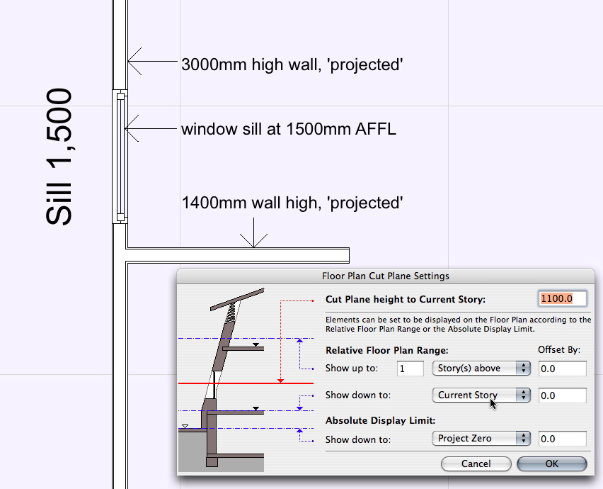

shouldn't be a problem. depending on your cut plane height:
in the example below...
cut plane at 1100mm (3' 7") AFFL;
wall with window 3000mm (approx. 10') high, base at 0mm, 'projected';
perpendicular wall 1400mm (4' 7") high, base at 0mm, 'projected';
window sill at 1500mm (4' 11") AFFL, 'symbolic'.
if you want your window 'projected' rather than 'symbolic', you need to raise your cut plane above the sill level and switch the low-level wall to 'symbolic' . . .
unless i'm misunderstanding . . .
~/archiben

__archiben
ah! i see link got there before i'd composed my reply! gold star sir!
Link wrote:
IMHO as a rule of thumb, it is best to leave your cut plane at one set height, and force the odd element to Symbolic where the Cut Plane does not cut through them.
agreed. that was the principle i was working to in my example . . . your solution no.1
~/archiben
b e n _ f r o s t
