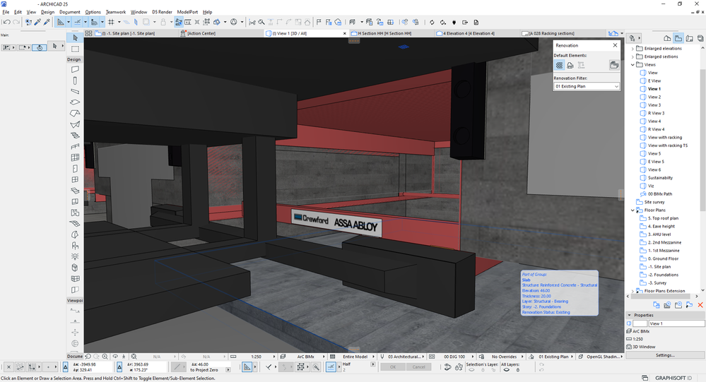

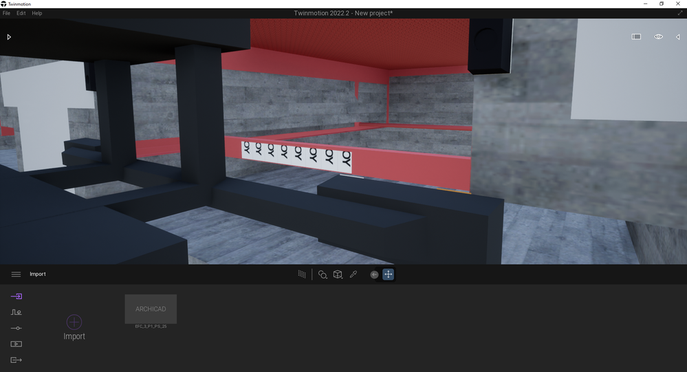

Graphisoft, Please get your plugins in order. The textures do not get across correctly, as the mapping is off.
Example Images attached.
Archicad 25 5001/6000, TM 2022.2
Back to 24 and the Direct Link that at least does not do this. It loses the textures completely after a few updates, but hey, what is it among the friends?

Nah, although it can help. The settings in TM can help with the textures folder (by default it is the local disk, and can be reset to the subfolder of the model location). That is not a big issue, and can be sorted.
The mapping is the problem, since it is not "this is the model, render it" scenario. It is live work in progress with many back and forths, checking, testing... designing. Not set up for the real work, definitely.
