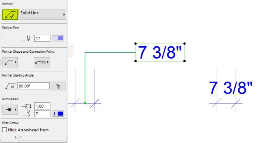

What I mean is that when you double-click on a tool, the settings you use become default for that tool. You cannot do that for just the dimension text, nor can I save it as a favorite. I am not talking about the dimension itself, but the text.
The dimension text on the left is the current default dimension. The dimension text on the right is what I want. How do I set the latter as default?

I think what your after is to have the Pointer settings on as a default and included in Favorite settings. I don't think you can do that. You can of course turn the Pointers on or off of a dimension chain or individual dimension, but you can't have it always come on by default. ? I think I remember when it would be on or off by default.

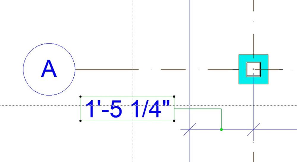

Thanks. The pointer was the key. Once I double-click on the dimension tool and set it the way I want it, included the pointer, as a default, I place a dimension (right side). If I want to move the dimension text and have it show with a pointer, I click on the dimension text first (right side), then click on the Pointer setting tool (highlighted in yellow) and it moves the dimension text and puts the point the way I want it (left side dimension).

You can only get the Pointers to appear after you place a dimension and Apply the Pointer. The Pointers will never appear by "default" when the dimension is initially placed. Someone correct me if that is not correct.
