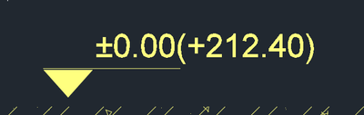

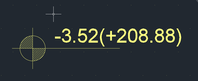

1. is it possible to have in the level dimension tool in floor plans and elavations for example in the same text the absolute and the sea level??
e.g. 0.00 = +235.00

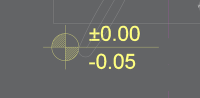

2. Also is it possible to have a level dimension like this that show the concrete level and above the final level?
especially for the excavation plan

1. Yes you can use the custom text value and have there:  <MeasuredValue>¶<ToPzValue>.
Further reference here: https://help.graphisoft.com/AC/24/INT/_AC24_Help/140_UserInterfaceToolSettings/140_UserInterfaceTool...

You should add some details regarding your AC version and you computer specs as this may affect any resolutions to your questions. From one of your other threads, you are using AC23? From AC26 onwards there is an option to reference the Structural level of a slab instead of the top finish level.
