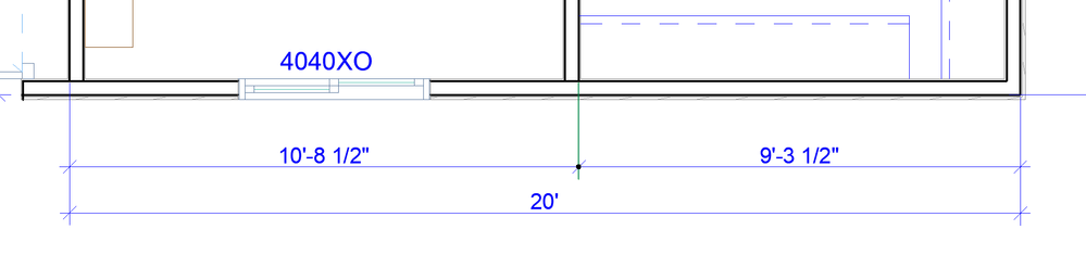

When I attach a dimension to the core of a wall on the non-reference side then the dimension node disappears when I click out of the view. If the node is attached to a skin or the reference side of the core it won't.
Is anyone else experiencing this. This has got to be a bug.

Here is what it looks like in the view when attached to the core on the side that is not the reference line.
Here is what it looks like when I click on the sheet tab. It won't happen when switching to another view. It happens when the sheet updates the view.
Here is what it looks like when it is attached to the reference line of the wall.
It won't disappear when attached to the drywall. It only disappears when attached to the core.
I can't seem to duplicate it in the out of the box template. How can I share the file for a tech to look at it?
