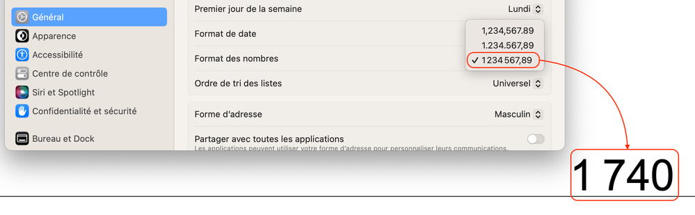

Hello,Could you tell me how to remove the comma that appears in the dimensions?

Solution
Rico Suleyman
It depends on the system settings.
On a Mac it's under General > Language and region > Number format. I think there's a similar setting on Windows.
You have to restart ArchiCAD to see the change. Be careful though as it will change the number format everywhere in your system, not just in ArchiCAD.

Thank you for responding, but I'm uncertain if my question was clear. Let's assume the dimension is 2300m. After formatting, it appears as follows: 2,300m. However, I prefer not to display the comma.

Merci beaucoup👍
It works. Thanks a lot.

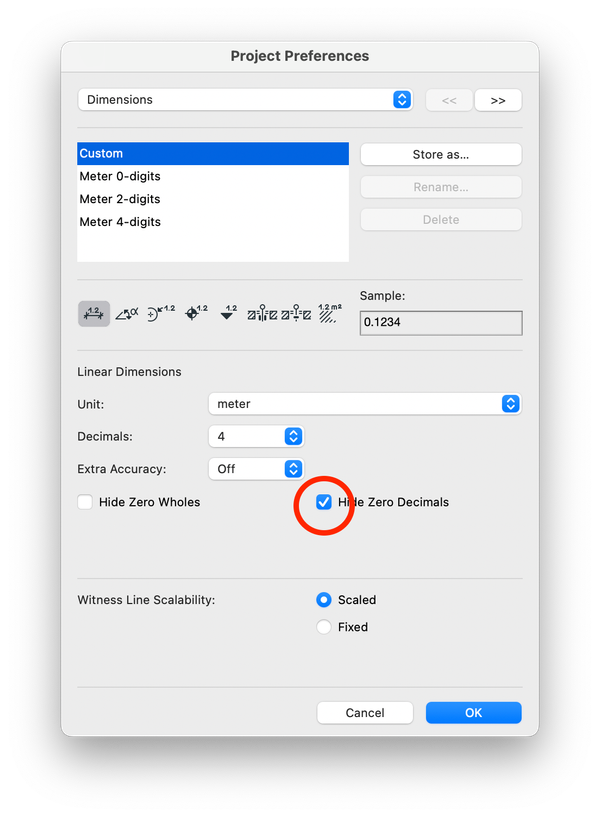

iggiv
I am experiencing a similar issue, but it seems to occur only with a fraction of a meter. All other aspects are functioning correctly, and I have adjusted the system settings at Language and Region to display values as they should be.

iggiv
To anyone who may have this issue too!!
SOLUTION:
I had the wrong setting within Archicad PROJECT PREFERENCE" at the DIMENSIONS where the box HIDE ZERO DECIMAL was not chosen.
Hope this helps someone else.
