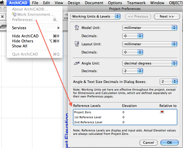

Claudio, you are still in version 12, see attached.
Levels & Project North is found in 14.
Rod Jurich

I've seen Levels & Project North on AC14 and, beside the North, has the same option of changing the Project Zero, 1st Ref Level, 2nd Ref Level.
I therefore have the feeling that my first question wasn't clear enough. I'll try to reformulate it.
I am working on a job which is a refurbishment.
The slabs in the entire building are not horizontal, thus, in the basement level we decided to use the new ceiling as 0.
The model has been drawn using the M.S.L. and we don't want to change its position in the space. Though it would be convenient to have the level 0 set to the ceiling height on internal sections and elevations.
Is that, perhaps, what 1st Ref and 2nd Ref are there for?

Yes. Select one of the Reference Levels, change its name to something informative and its height relative to your M.S.L., then it will be available as per my original post. It will also show up other places (for example Mesh Point Heights) where it can be used for input, not just output.
