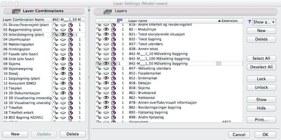

I´m having problems getting dimmention markers for the 1:50 not appear on the 1:100 drawings - even though they indeed are placed on the corresponding layers. They still appear on both Plans 1:100 AND Plans 1:50 in View map.
What am I missing?

Placing them in separate layers is not enough if you are saving your views without setting up layer combos. Are you using layer combos correctly?
Yes. My layer combos are correct. Meaning only 1:50 layer is set to be visible in the 1:50 drawing etc.

I´m talking about dimension selection created by the Dimension Tool. See my first picture.
The two other pictures are showing what I believe is the correct settings for the layer combo.
I would expect to only show 1:50 markers in the 1:50 view, and 1:100 markers in the 1:100 view.

- Posting the two layer combos in additional preceding posts.
Her is the 1:100 layers combo
Her is the 1:50 layers combo

So if you have the 1:100 layer combo set, and you select the 1:50 dimension, it still shows in the settings as being on the 1:50 layer which is turned off?
Yepp!
That how it is right now, and I don´t have a clue to what is wrong.
Can you make anything from my images?
No, sorry. I was hoping it was going to be something logical, such as duplicate dimensions on both layers, but that's just weird if they are displaying and their layer is off.
