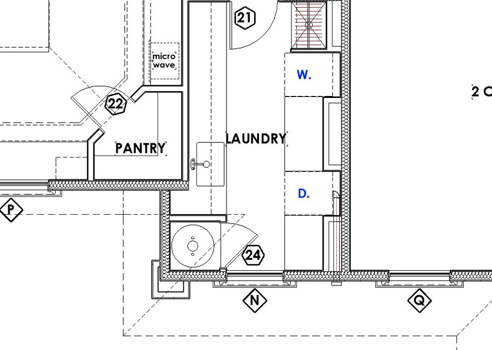

I have the plan view door and window markers and their auto schedules working great. Now, is there a way to have the markers and ID's show on my building sections and exterior elevations? I'm using the Window Marker_NCS 17 and the D Marker 17.
Doors are a hexagon with a numeric ID
Windows are a simple square on end with alphabetic ID
I'm using AC18 (not sure why I'm using AC17 markers maybe because they simple)

I have the 4 exterior elevations plus 24 building sections (six sheets with 4 sections each). I did the process and only was able to get a label box with the ID and the arrow pointing to the lower left corner of the window. It needs to be just the ID in the same box shown on the plan. In my case it's a square on end for windows and my doors are a hexagon. On the plan the markers originate from the door and window settings and a selected marker, not the label tool. What was graphisoft thinking on this?? It really needs to be the same marker used on the plan. Turned on or off in section elevation by selecting those door and windows that you want ID's on from the section and selecting, "markers on", from the palette options in the same way and from the place you would select the "change selections to morphs". Why couldn't they have done something like this?
The way this is now, I would have to go in and place a 2d symbol around each ID to get them to match my plan designations and what am I supposed to do with the arrow? There is no option to remove the arrow in the label tool. If there was an option to remove the arrow and the ability to select the shape of the label box the ID is in, this would work for me. If you look at the screen shot of my plan a few posts above this one, youi can see that I was able to have the markers with no arrows and the ID's are inside the hexagons and squares on end which help to further distinguish doors from windows respectively.

The method I described using the Cadimage label or generic 18 label does not have the leader line/arrow, but alas is just a standard rectangle.
I use the oval for windows and circle for doors and would like to replicate those on elevations too, but at least I can set them on, and the rest is done for me.
Use the Label Window Marker 18 and check Use symbol arrow.
Jonathan wrote:
If there was an option ... and the ability to select the shape of the label box the ID is in, this would work for me.
Use the Label Window Marker 18 and under Symbol Label > Options > Polygon Shape > Rectangle.
