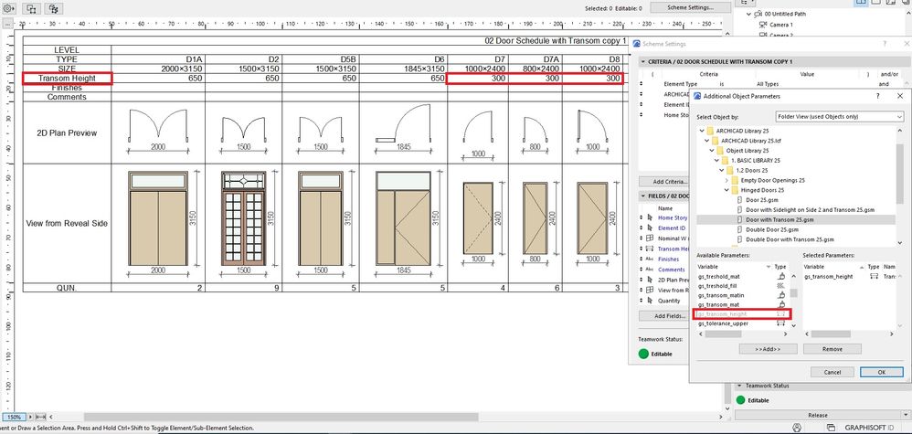

in door schedule, Door 25.gsm, which does not have option of transom by default, still shows transom height as 300.
Do we have any solution for this so that doors without transom do not show any value in schedule?

Unfortunately, this comes from the Library Part.
Every parameter that is defined in a Library Part was a default value. In the case of the "gs_transom_height" parameter, that default value seems to be 300 mm.
Even when the parameters is not used by the Library Part, the parameter value is still there and will be displayed in the schedule.
If the parameter is used, you set its value and that value (which may or may not be different from its default value) will be displayed in the schedule.
You should make a wish because Library Part parameters are not coded to respond correctly in such a use case.
