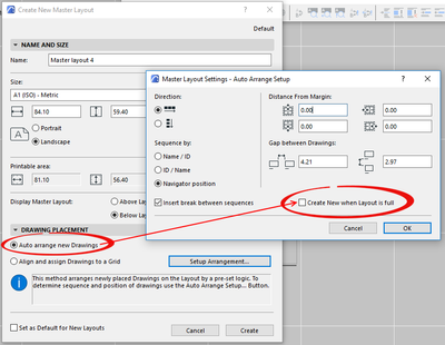

This is the setting i was thinking of.
I am not sure why the default drawing tool settings (fit to frame) are not influencing the newly placed drawings.
I did notice this just the other day but have not gotten around to investigating it yet.
Ah, yes, under the 'Auto Arrangement' button
