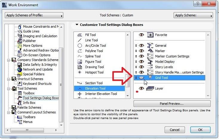

Grids are best set before sharing the project. If it is necessary to edit a grid element, it is best to have all other users release their reserved elements and you reserve all of the elements in the project. If your organization is large you may wish to ensure no users can change the grid by removing the grid tool operations from the Site’s standard work environment scheme. This is done with each tool that allows the grid tool modification for instance in the below example the elevation tool has the grids tools access disabled.

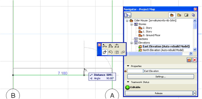

Editing Grid Dimension Lines in Section
If you reserve the Dimension line of a Grid element in Section, you can edit it as usual, provided that the Section you are working in is also reserved by you:
However, if the Section you are working in is NOT reserved by you, you cannot edit the Dimension line until you do reserve the Section:
In this situation, first reserve the Section, then edit the Dimension as usual.
