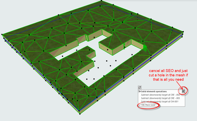

However I am having trouble with your site mesh.
It has 139 Solid Element Operations which are taking a very long tome to calculate.
So it takes a very long time to generate in 3D or the west elevation (that has to distance limit so can see your model).
If all you need is the hole in the mesh, then cancel all of the SEOs and just cut a simple hole the shape of your building.
If you do need the SEO the maybe don't select everything and subtract.
Just select those elements that will cut the mesh.
