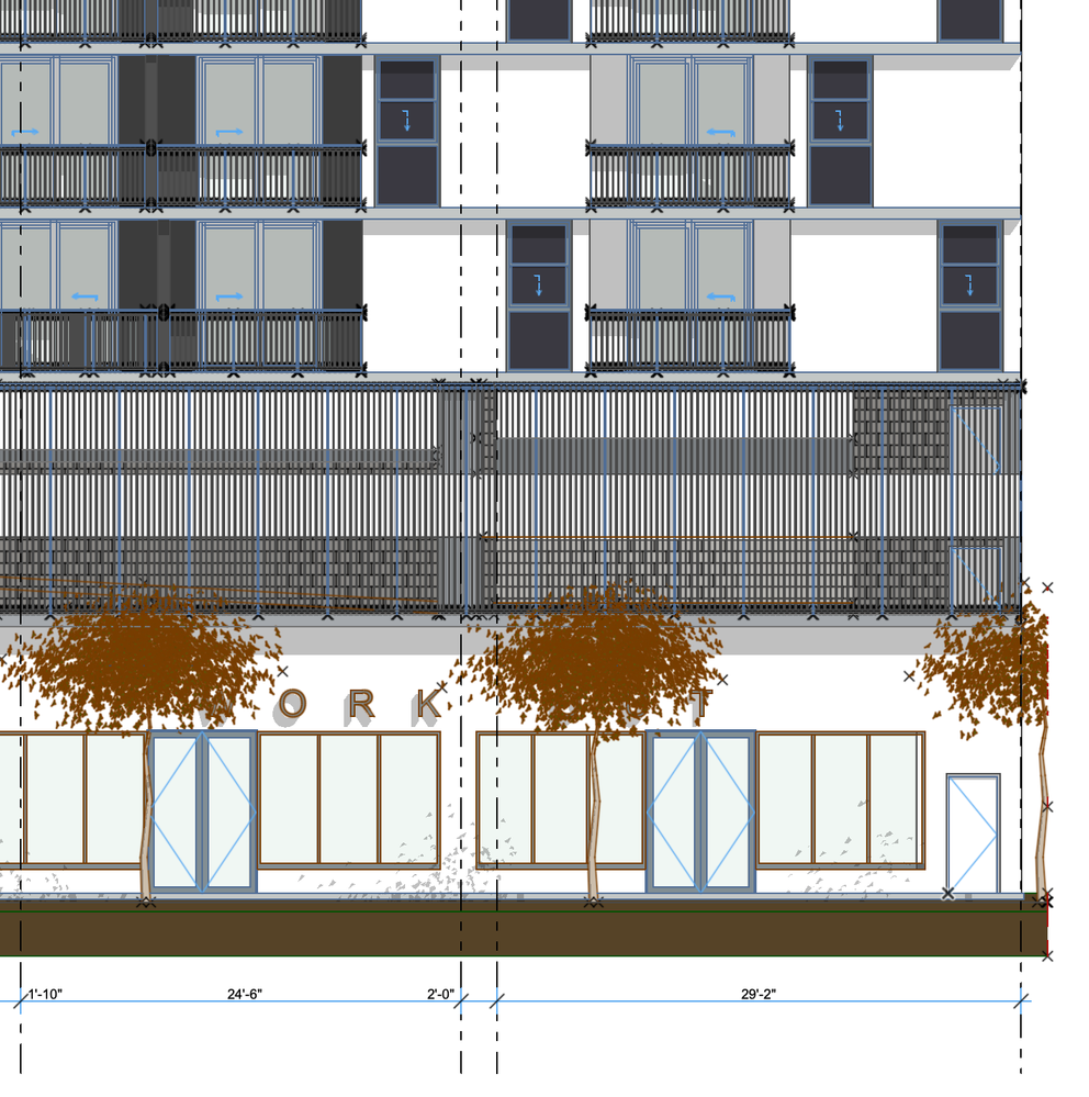

All my elevations, sections and wall sections suddenly changed into 2D lines and Fills. I don't know what I did wrong and why this happened.

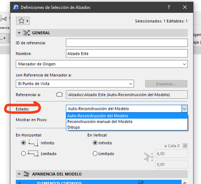

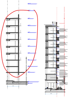

Jp1138
Well, sorry for the delay, it´s been a crazy week.
It seems many of your sections and elevations are made as independent views.
This views don´t generate from the model, they are just a drawing you make and can be referenced to this position in the model.
https://helpcenter.graphisoft.com/user-guide/137234/#XREF_40192_Create_an
As these sections are not generated from the model, any changes you make would not propagate to the section.
Maybe the last section you draw was a independent section and selecting the tool is taking the previuos configuration.
If you want to have a live section, be sure to select a section source maker, not a independent view section.
Your independent views cannot be made a live section again, but you can make a new section in the same position and copy and paste your drawn lines on top of the live section, so you can keep the elements you need that are ot on the model. Here I pasted your section WS01 besides a new real live section on the left.

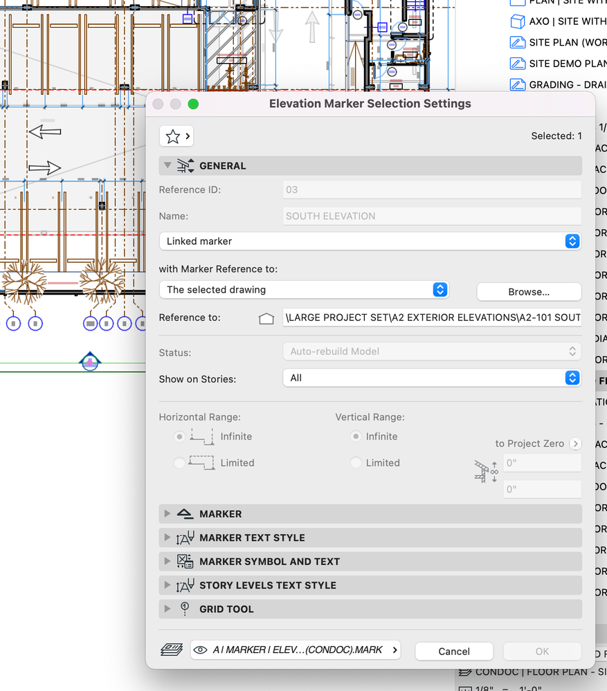

If you have an Independent Section Viewpoint, then you can place a linked Marker, select it to link to the Independent Section, click OK to accept changes, then go back to the Dialog and change the Marker to a Source Marker. Then you will have a Section Viewpoint that generates 3D and can be updated when the model changes.

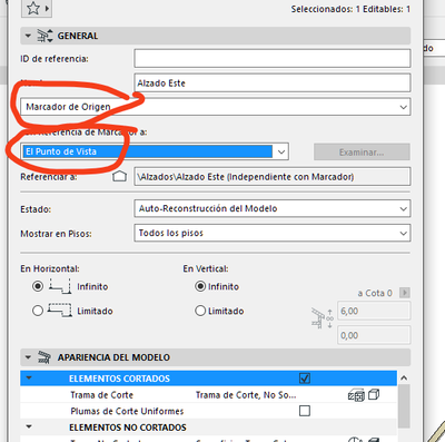

Jp1138
I suppose somehow this got changed in your elevation and section view definitions (sorry, my Archicad is in Spanish, I hope you got where this is located)
ARCHICAD 29 SPA (as long as the server works)
Windows 10
Edmon
Thanks Jp1138, but unfortunately (for me) the status mode is kind of greenish. I can change it. I'm not even Know haw that happened. BTW. I speak Spanish too.

Jp1138
I think your problem is here:

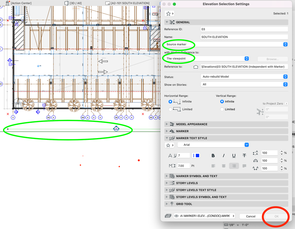

Edmon
Thanks again Jp1138, you're almost there. I change everything as you direct me but now I can't hit ok. I'm desperate. I'm loosing a lot of work. elevations, sections and wall sections.

DGSketcher
Legend
The OK button is usually greyed out when the element you are editing is on a locked layer.
Jp1138
I think, as DGSketcher said, that the layer is blocked: you can see it´s in italics in your screenshot:

Edmon
Thanks Jp1138 and DGSketcher you have been very helpful. I've done everything you guys have told me to do but the elevations and sections didn't change to their original 3D state. I decided re do them all over again but I don't want to repeat the same mistakes. How should I accomplish this task without the fear that it will happen again?
