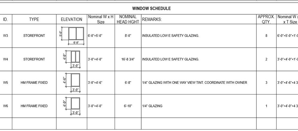

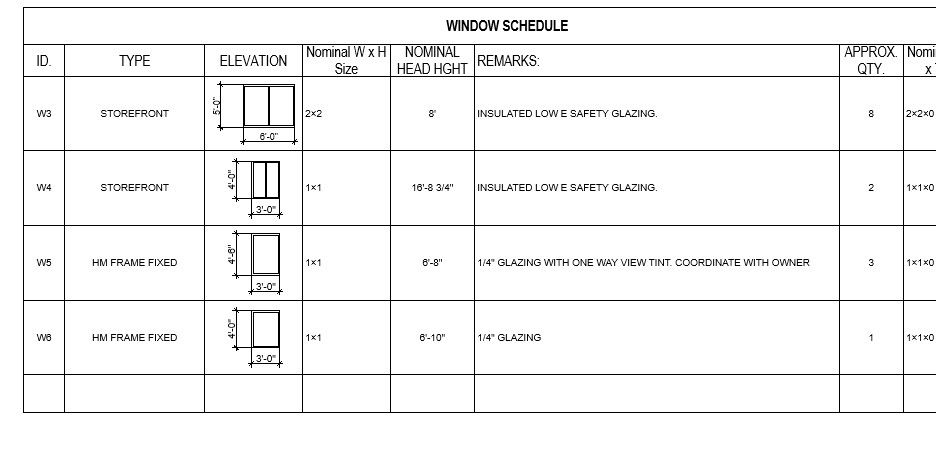

Archicad 27 -  Error in window and door sizes when the Archicad schedule placed on layout.
Sizes in schedule are correct but when schedule placed on layout they change to 1x2, 2x2 etc.
Attached are both the actual Archicad schedule and the schedule as inserted onto layout.
Have tried all parameter/fields that are associated with door and window size and each has same error when inserting on layout. Any assistance is appreciated.

Took me awhile to figure it out.
To fix manually - I think I just changed the Dimensioning setting in the View Setting for the Schedule. See pic.
The latest hotifix did seem to fix it in the schedule but I think the Dimensioning setting in View Setting still showed "Missing (Building Scale).
Hope this helps.
Thanks
