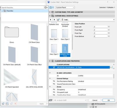

How to export then Import the custom door that I have saved in the favorites as GSL-CRTN-Wall-Door?
(I do not want to export/import the entire library. Alos, I need to export the door from one computer and import it in another computer).

Hi Gisele,
Open the Favorites Palette. There you'll find the Import/Export Dialog when you click on the Gear Icon:
Be sure to use "Selected Favorites Only" if you want to export only one favorite.
Best,
Bernd

Sorry, I don't know what you mean with "Import/Export icon". My best guess is, that you mean where to find this specific  "gear icon" maybe?
In my previous answer, I'm using the "Favorites Palette". It's located under the menu "Window -> Palettes -> Favorites". (Step 1 in following picture)
It looks very similar to your screenshot, but it's a different Window! (You are accessing the favorites in the Curtain Wall Tool Settings)
I've made this step by step guide in case you are stuck at a different step.
