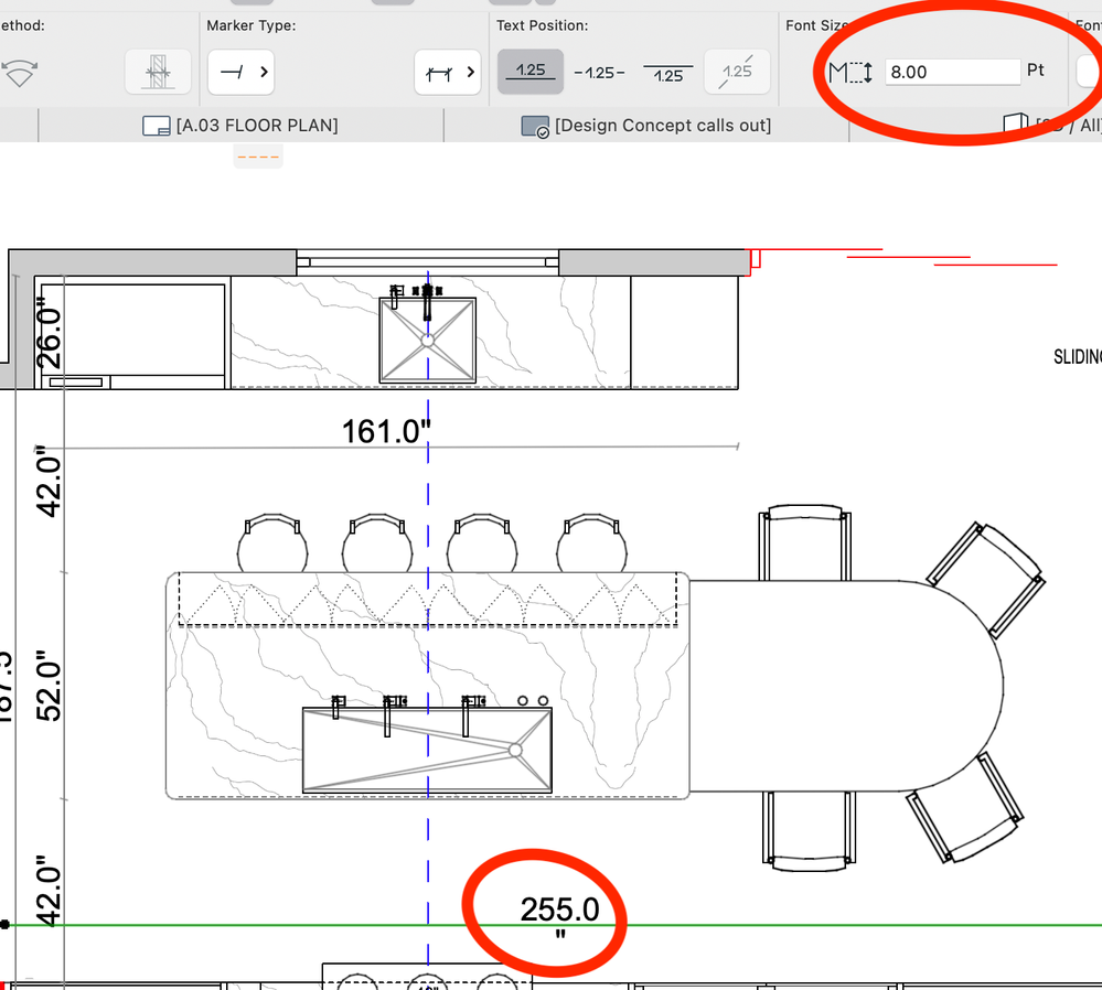

On printscreen attached are also schedules that I put in 7pt which seems to be readable nicely without zooming.... but if I place it on drawings (see printscreen), it looks gigantic?
Am I doing something wrong?
Can I see somewhere exactly how it will look the sizing font printed? (will it be readable?)
If not, .... could someone please suggest what would be Ideal font size and line thinness for 18x17 paper so it's clean, visible and not blurred?
Printscreens attached + printscreen showing larger font text for dimensions that are readable (7pt) .... BUT it looks just huge....

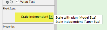

But I set my text to be 'Scale Independent'.
That way if I use 2mm text, then no matter what scale I set, I know the text will print at 2mm on the page.
I know it is fairly comfortable reading text that is as small as 1.5mm and can go as low as 1.2mm at a stretch.
On screen of course it depends how much you zoom in/out, but you know the text is the size you want to print it at.

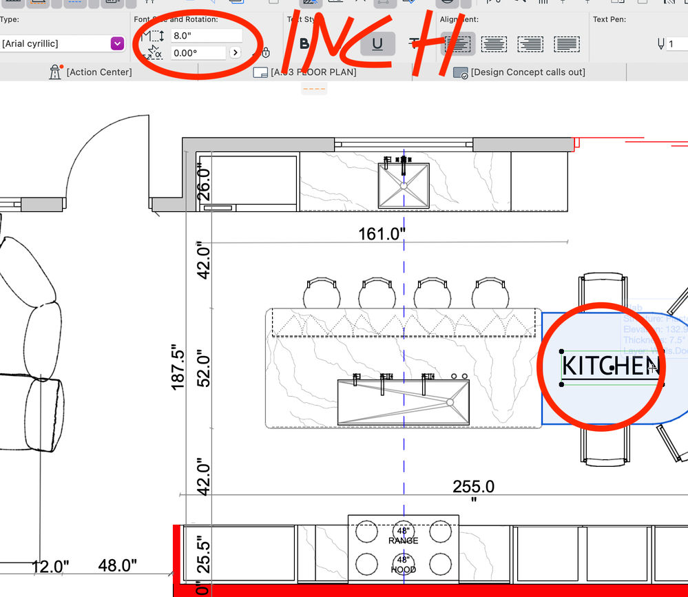

Ok this is perfect thank you very much! I just noticed that my archicad fonts are actually set up to inches (instead of pt or mm), while my dimensions and line sizes are in pt only. By any chance would you know if I can set up both samely, or some convertor? I would like to use 9pt for floor plans but I used some converts and it shows as 0,11" which is miniature... and does not look like 9pt dimensions that I set up correctly :((((( I don't know why archicad make this super Difficult I just spent whole day setting everything up only find out its not even same :D.
