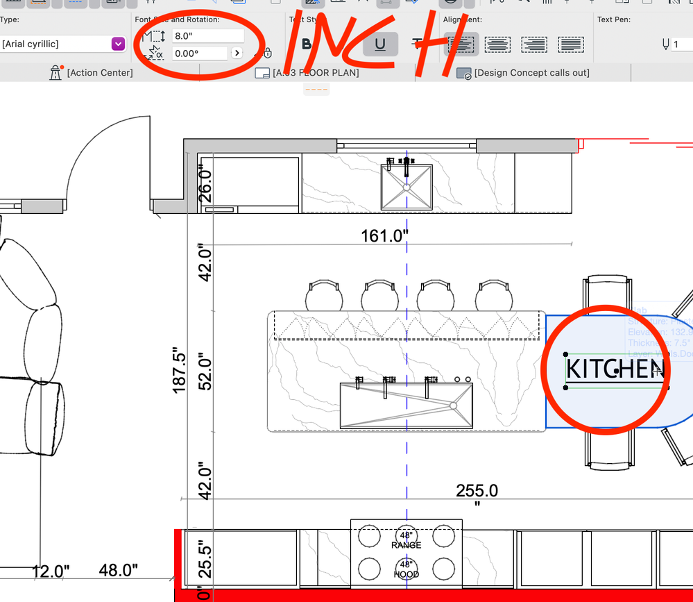

After having a great feedback on font sizes in previous posts,  I decided to use 9pt on floor plans as size for dimensions  & text/annotations.
I wanted to share my confusion about different sizing in PT and INCHES - and if someone would have solution for this?
I am trying to set up THE SAME size of fonts for dimensions and text. However, dimensions show in PT, while text in INCHES.
I converted 9pt to inch which seems to be 0,011" and that is not even seen by a human eye.
Is there a way to set up PT for both (fonts & dimensions numbers?). Do I really need calculator to convert this? Please could someone helpppp

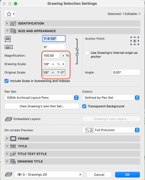

When will this not be the case - that your xx point dimension text won't print as xx point?  When you change the scale or magnification level [they are linked] of a placed drawing on a layout from the scale at which the saved View for the drawing is set.  Here are the drawing settings for a plan view that was placed on a layout at its default settings... a 1/8" scale view creating a 1/8" scale drawing:
When the "Drawing Scale" and the "Original Scale" (View Settings saved scale) are identical, then 9 point dimension text will appear as 9 point text.  It doesn't matter what the scale is ... as long as they are the same.   Typically, they should be the same.
If you change the Magnification to 200% (which in the screenshot would automatically change the Drawing Scale to 1/4" ... although the Original Scale is still 1/8") ... what should have been 9 point text will now print as if it was 18 point text.  Similarly, any fills (hatch patterns) will be enlarged... vs scaled, which is most often not what is desired.

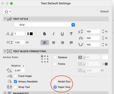

@cocoloco As in the other discussion, you only see inches if you have chosen to display text in "Model Size" rather than "Paper Size".  Here's the setting:
If you flip back and forth between the two in the settings dialog, you'll see the height box units change from Pt to inches (when you're in North American Imperial units).
For Paper Size, the text will appear in the point size given on the output even if the model is at different scales on the layout sheet.  (For annotation where you really want the same text size, it is essential to understand the 9 positions for the Anchor Point so that at different drawing scales, the text will appear in a reasonable position.)  For Model Size, the text will be fixed size in model units and will be larger or smaller depending upon the scale with with the model is printed.

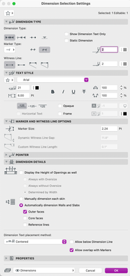

Hi Karl,
I think I understand, and it works well for the text/annotation so that is now clear to me and really helps. However I am also struggling with dimension sizes  because I don't see option to turn on scale independent or model/paper size therefore only option I see is PT. this below is my option in terms of setting up dimensions sizes.
Therefore I don't even know what will show on print blurred or not, if it's same with text or not  .. Please please could you check if you have the same setting options like I do when it comes to dimensions? Thank you @Karl Ottenstein
