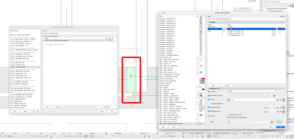

I have a plan called "Framing Plan" where I created a graphic override "greys" out the walls in the background so the framing information pops on the plan for the structural consultant.
There are a few places on that plan that I have places small patches of Fill Patterns to clean up the drawing.  However, for some reason the graphic override I created will not change the fill patterns to "grey" out even though they are in the recipe as well.  See attached screen image.
I have seen this before where fills joist dont seem to cover up other items or behave as expected before.
Anyone have any insight as to why this might be happening or better yet, can you point me to a fix.
Thank you!

Finally figured it out, I needed to add the layer name of the fill into the Graphic Override "recipe".
