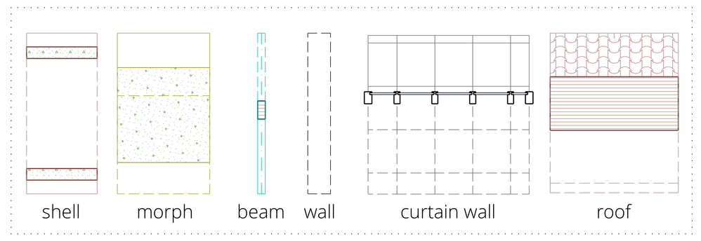

ARCHICAD construction elements on a floor plan usually can have 3 different displays.
  • projection
  • projection with overhead
  • cut only
Using Projection with overhead is a similar look for different element types:
There are a few exceptions though, having additional floor plan displays:
  • the Wall, which has a symbolic cut view
  • the Curtain Wall, which has symbolic, hybrid and projected projection modes
  • the Stair and Railing Tool which have floor plan symbol layouts
