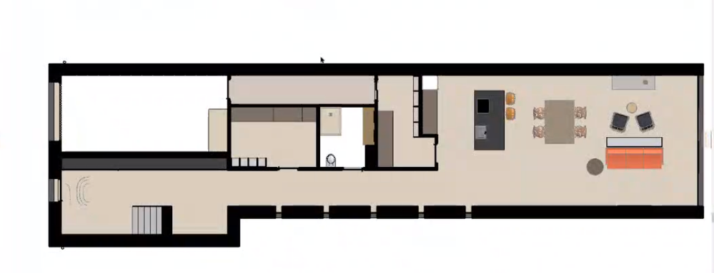

Hello, I am pretty new to Archicad and I may not understand everything that well. The problem is that i've made floors in my project and while viewing it from the top, the structure of the materials doesnt show. I don't know how to describe the issue that well so i'll be adding a screenshot. Some of the flooring in my project is made for example out of tiles and in this view every floor looks the same. Please and thanks for help.

Unless this has changed in AC24/25, the representation of floor finishes is controlled by the Cover Fill of the relevant floor / slab / etc. By default this is set to match that of the top surface, in which case the pattern can be defined under the individual surface settings.
Options => Element Attributes => Surfaces => [Relevant Surface] => Vectorial Hatching
