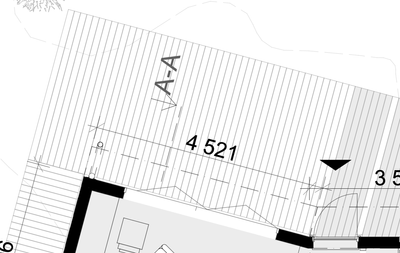

Hi all,
I'm struggling to figure out what i need to do for get the right appearance for a floor plan of mine.
On "ground floor" level the problem is that the contour lines of the ground mesh is visible through the wood deck - at least the ones that are beams, not the morphs for some reason.
On the "ground level" below the contours of the ground mesh are not visible through the wood deck.
I have tried with different floor plan displays but i can't find the issue why I reach out to the community.
I bet there is a simple fix to it...
Problem at the ground floor level:
Desired result where the contour lines are hidden by the wood deck but on the ground level beneath ground floor level:
Thanks in advise!
/André

Looks like your GO is turning off your Background Fill. From memory, morphs do not have a fill.
Ling.

I still can't find a difference in floor plan display or different graphical overrides that could generate this "error".

The top image is your Ground Floor Plan, whilst the second is your Footing Plan? Your deck is a Slab? Is it's Home Story your footing plan? Check the slabs Floor Plan Display  settings?
