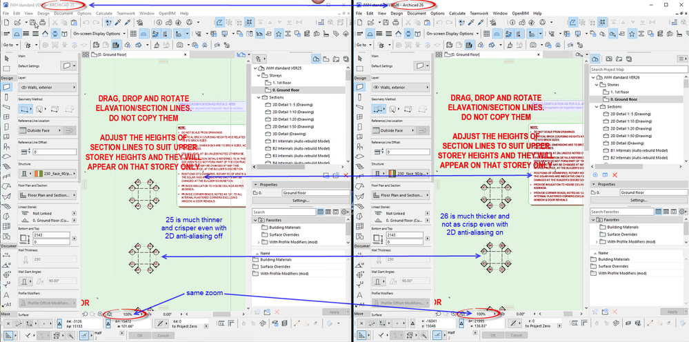

I did complain about it in Beta testing and GS's response was that 2D ant-aliassing should be turned on by default now.
I have always worked with it off as I like to see the 'jaggy' lines when a wall is not quite horizontal or vertical.
Even with 2D anti-aliassing turned on in 26, it is still not as nice as 25.
In this image it is off in 25 (on the left) and on in 26 (on the right).
It just looks a bit fuzzy now.
Of course it clears up as you zoom in and I am hoping I won't notice it so much when I am not comparing them side by side, but I am really hoping that GS can do something about this sometime soon in the future.
But just the fact that many have noticed this, must mean there is something wrong.

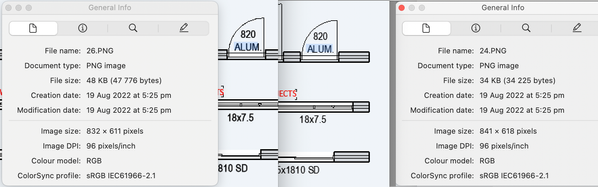

Interesting and definitely different. Whilst preview sees it as a font it doesn't know what 'type'
The font image in 26 is heavier. The overall file size is smaller in 24 but has more pixels

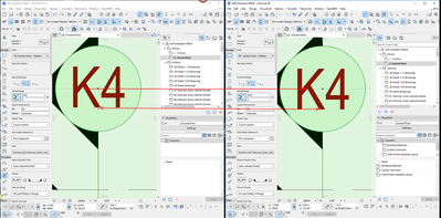

I could possibly try to squeeze both 24 and 26 onto the same screen and snap it one go. Would that provide any more information for you?
EDIT: I went ahead and did it anyway. Definitely noticeable side-by-side
undefined
AC27 Build 5060 AUS - Windows 10 Pro, Ryzen 7 5800X, RTX 3090, M.2 NVME 0.5TB SSD, 32GB RAM
Hey Barry,
As a reference, I have done the same thing - both images on the same screen. Definitely noticeable.
undefined
The text is definitely moving - even if only by a little bit.
You can see here by the grey section line in the background.
And this is just Arial Narrow - nothing fancy.
And the font is jaggier in 26 even with 2D anti-aliassing on.
