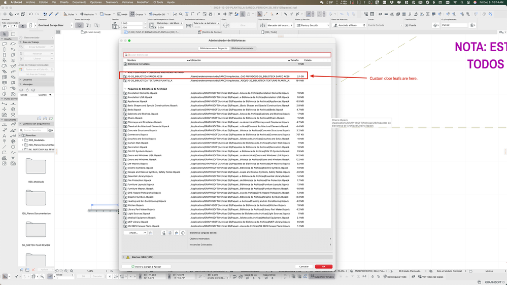

In this first screen shot, you can see that I am selecting the garage door from the Global Library garage doors and the custom door leaf list is empty.  It should display our custom door leafs that we have in our company library which is loaded onto the file.
The screen shot above shows my library manager, where we have our company library loaded, as well as the libpacks of the new Global Library.  This condition corresponds to the status of the behavior of the previous screenshot.

Thank you for the reply, however this does not seem to be working (the subtype option).  Even though I change the subtype to "Custom Door Leaf" and then I create a new Custom Door Leaf from scratch, then only one that populates in the list is the new one I did from scratch.  So still something does not quite work.
At least I may have found a workaround (by accident).  If I drag and drop the gsm file of the custom door leaf or the custom door handle that I need onto the floor plan view, it will insert it as an object, which I can then turn into a morph and then save it again as a custom door panel or custom handle using Archicad 28, at least saving the time to model everything again....  Not ideal but it will have to do, although now we found another problem related to the surfaces and language that I will need to solve first, but I will create a separate post for this.
