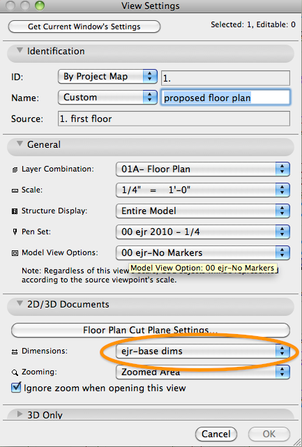

Eduardo Rolon
Check that your Dim Settings match the saved ones that are part of your views.

Eduardo Rolon
The settings saved with your Views

Hi ejrolon,
Thank you for replying. I have found the first picture you added. the overall project settings but where do I go for my View Settings?
I've been at this for quite sometime and... am lost.
N.
Eduardo Rolon
It is the setting for the View that you save from your model and place on your layout for printing.

Thank you!!
It worked. *relief*
You were very helpful.
Cheers!
