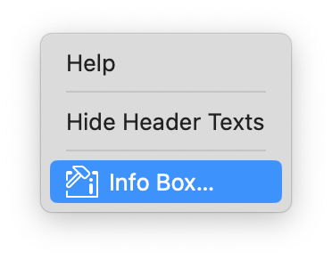

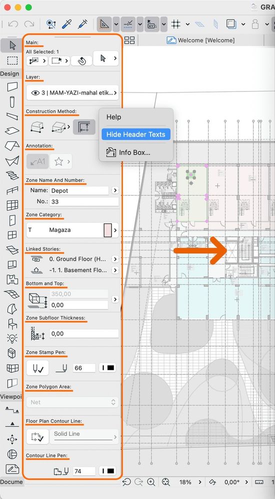

  1. Hover over the Info Box palette.
  2. Right-click to open the context menu.
  3. Select the option to “Hide Header Texts”
In the same context menu, the palette can be further customized by selecting the Info Box… option.

Here, it is possible to change the order and visibility of panels in each Tool’s Info Box:

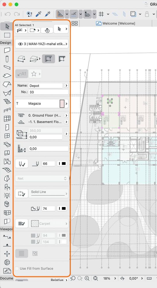

The outcome
By hiding header texts and customizing panel visibility in the Info Box, you can reduce clutter and keep tool options accessible, resulting in a more open and efficient workspace.
