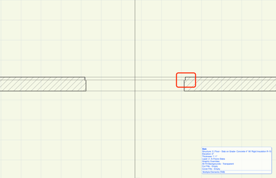

Hi All,
Whenever I applied the Reflected ceiling plan override, some of the window line contours don't show up, it only happened with windows, not with openings and doors. I´m attaching a  screenshot, if any has a solution that would be appreciated.
Best Regards.

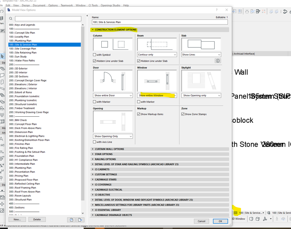

It could be Model view options or Graphic Overrides.
To troubleshoot, if you have a view where they do show, try temporarily switching the Model View Options to one you know works? That will rule out MVOs.
If you switch the Graphic Overrides to no overrides, that would rule out GOs.

If it was MVOs, it would probably be this
