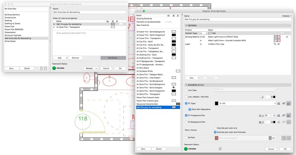

Hi all,
I'm trying to achieve something that doesn't seem possible (as usual).
See attached. My goal is to override the fills of ONLY new walls on A-WALL-FULL to have a solid grey fill, EXCEPT walls that are using the two fills specified in the rule.
There doesn't appear to be a way to restrict it to only new walls.
I could create a custom Property and use that to classify the walls and apply the GO rule, but that adds an extra step for the user that I want to avoid.
MORE DETAILS:
Our company standard is to graphically depict 2 of our most common interior partition types with the striped fills you see in my screenshot.
Our other standard is to show existing elements with grey lines and fills, while new elements would be shown with black lines and fills. This makes the new work obvious when looking at our drawings.
Our old method for doing this involved having separate partition types (wall composites) for remodeling projects with alternate fills. I'm trying to remove the alternate partitions from our workflow by utilizing G.O. to handle this instead.
So, I'm not opposed to some lateral thinking to achieve my real goal if G.O. are too limited for what I'm trying to do.

To sort of answer my own question, here's my workaround:
Set Renovation Override for NEW cut fills to swap the foreground and background colors. This causes the stripes to invert (same difference) and the walls with white fills to change to grey fills.
Anyone have a better idea?
You might want to play around with the "Show on Renovation Filter" criterion in the "Identification" section of the Criteria for Rules. It was broken before, but I believe is supposed to be fixed now. You could even create a renovation filter that was just for "New" objects only, if it helps.

I actually did try the "show on renovation filter" option and the result wasn't what I needed, although I can't remember exactly what the result was.

Eric,
The "Renovation Status" parameter of elements is now available as Graphic Override Criterion in the Graphic Override Rules Dialog of ARCHICAD 21:
https://helpcenter.graphisoft.com/tips/archicad/archicad-21-small-improvements/#Use_Renovation_Statu...
