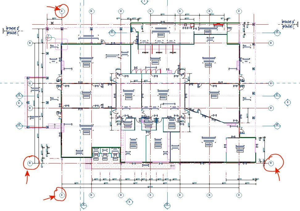

~/archiben wrote:
i assume that you've only turned the grid marker heads on for the north and west sides of the grid rather than all the way around?
the grids seem to be some kind of 2.5 dimensional object: so if the view is looking away from the marker heads (i.e. the marker heads are behind the section line) they won't show?
is that the issue?
~/archiben
Do you mean both ends of the gridline? Both are on - see pic.
fair enough. just a thought . . .
