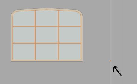

Hide window sills in exterior elevations?
I'm using the "Three-centered Arch Top Window" from the window library. The sills are sticking out in elevations as shown below...
I can't find a setting anywhere that lets me hide the sills in these elevations (unless I over-paint them which I'm trying to avoid). I could just turn them off, but ideally they would appear in 3D.
Any ideas?
14 Replies 14
You can turn the sills off, but they will be off in all 3D and elevation views.
Unfortunately you can't turn them off only when they are viewed side on.
The sills protrude beyond the wall face, so from side on you will see them sticking out.
You could set them so they don't protrude, that way they will still look correct from front on in an elevation.
But they will be wrong in 3D.
You can't win.
If you really don't want to see them from side on, you will have to cover them with a fill, but that could be difficult trying to match the brickwork.
I would say that is how they will look in reality, so leave them as they are.
CosminF
I tried to hide it using MVO, and couldn't. Graphic overrides won't help.
Same issue was expressed here, and again, the answer was: not possible.
https://community.graphisoft.com/t5/Documentation/How-to-hide-side-window-trim/td-p/277809
Worst case scenario you could try to model them separately on a different layer - which can generate issues of its own.

Patrick M
Ace
model them separately as beams.
I know its a bunch of work, but you could have layers for Sills North, Sills East, Sill...
then each elevation has it's own layer combo.
there is almost always a way.
the great thing, and trouble with, BIM models... you can't fake it, unless you make things "less BIM"

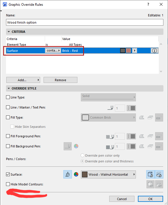

Ahmed_K
Mentor
I get an ispiration from @Patrick M ,
You can place your windows normally, including the sill, then, create a property for facade orientation,
Then assign it to windows and doors, it's already usefull for energy calculations ,
Then with graphic overrides you can hide the window of any facade you want , using the hide contours command

mthd
Great tip @Ahmed_K for an energy calculation workflow inside Archicad. I have searched for information on this topic but can’t find much information on it. Probably good for Graphisoft to provide us with a webinar on how to do it ? I am interested in your method but that would need to be put into a tips and tricks part of the forum.
BulldogBen
I can imagine this working, look forward to trying it when I’m home. I’ll report back.
Thanks so much for everyone’s feedback so far.
