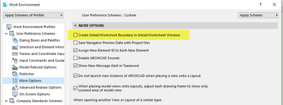

I never use worksheets or details (very rarely), but I am sure there used to be a setting in the tool to turn that boundary line on or off.
Seems now it is in the Work Environment.
Maybe it was there all the time and not actually in the tool settings.
This will affect new worksheets/details that you place.
Existing ones you will have to 're-build from source view'

Thanks so much Barry!
🤦‍  I would say why didn't I think of looking there, but to be honest, it's feel like it's quite an arbitrary location for that setting!
I went on a mission to find out when they moved it.  I only have access to workspace back to 15 and the setting is in there.  Maybe I did imagine it...
Thanks again! 😊
