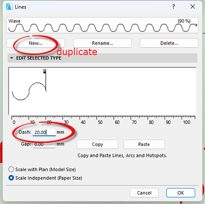

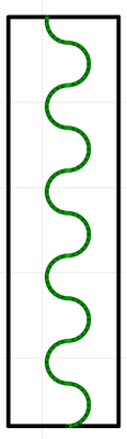

How can I adjust the width of the wave line. not the thickness.
nick1231
Hello,
I need to make the width of the line area match the container it is in.
How can I do that?
Thanks for any reply
1 ACCEPTED SOLUTION
Solution
If you have drawn the line as curves (which this does not look like) then you can use the re-size tool to make it bigger.
If it is a single straight line where you have used the 'wavy' line style, then you can edit that line style.
Duplicate it as a new line and increase the size of the 'dash'.
You may need to try a few times to get the correct size.

Where exactly can I find the line styles?
If i just right click on it nothing shows up where I could edit the line style.
Thank you
Thank you, I did as you said and it worked for me. I appreciate you for helping me out. To adjust the width of a wave line, you can typically do so by changing the frequency or wavelength of the wave. A shorter wavelength will create more waves in a given space, making the line appear narrower, while a longer wavelength will have fewer waves, making the line wider. When you're on the search for an essay thinker online, you've come to the right place. I visit this helpful website: https://letsgradeit.com/review/essaystate/, which has a dedicated review page for essay state. This platform allows you to hire an experienced essay writer who can assist you in writing your essay. In my experience, it's the best website out there. They offer expert help and have a track record of delivering top-notch essays.
Sorry for the late reply - I have been on vacation and not able to check all posts.
Options menu > Element Attributes > Lines.
