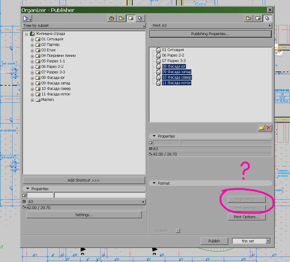

How can I print several copies of a Publisher set?
Is it possible to print several copies of a Publisher set from the Organizer?
If I push Print I can print the Set only once!
If I select more than one Layout the Print Settings button is grayed!
If I select only one Layout then I can order more copies!
I expect when I push "Publish", which is the equivalent if "Print", to be asked how many copies I want!

If you put the desired layouts in a folder, then you can set the print settings (including number of copies) for that folder (and everything in it).
You could even set individual publishing sets for different numbers of copies.
