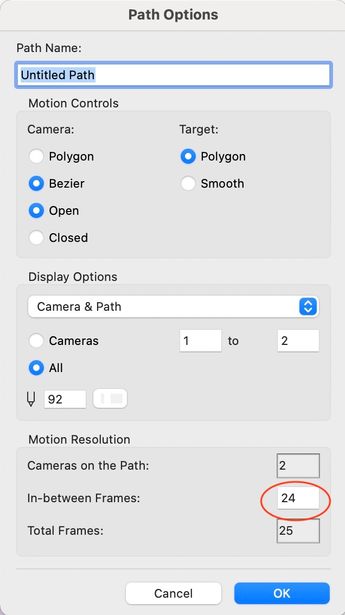

The camera path dialog where you assemble your cameras looks like this:
This lets you specify how many frames are generated on the path between the cameras placed in plan view.  And, this is where things get awkward/tricky in Archicad because two cameras might be 5 feet apart and the next camera might be 100 feet away.  If all three cameras are on the same path and have the same frame count for the in-between frames... then if the camera that dollies over 100' presents a pleasant motion - then the one that dollies over only 5 feet will feel tediously, awfully slow.
So, path management is just part of the issue here (vs other software).  The functionality here has not changed in 25 years that I can remember.

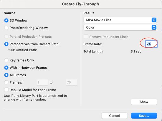

The generate fly through dialog:
is where you specify the frame rate for the frames that you entered in the path dialog... and so total frames is divided by the frame rate to get the seconds for the resulting animation.  You can of course change the frame rate to make things longer or shorter... but without sufficient frames per second, the animation will be jerky instead of smooth... so it is generally best to use a standard frame rate like PAL, NTSC, or in the screenshot the default is 'cinema' of 24 fps....  Then if you want things longer or shorter, specify more or fewer frames in the path dialog.
It all works the way it always has for me.
