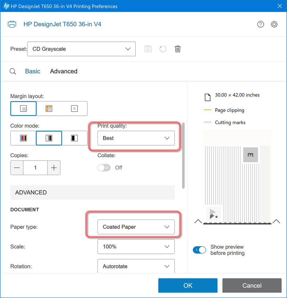

I am not sure why the print would look more pixelated than the PDF on screen, unless it was a setting in the printer driver.
I noticed that my HP DesignJet T650 driver defaulted to "Fast" rather than "Best" before I made my own preset. Maybe something similar on your printer? Paper type setting can make a difference too.

Thank you for the response, the printer was defintetly having trouble. I used Adobe to open the file, although it took some time to load all the details, it finally opened with zero lag.
I took a step further to optimize the PDF document (reduced it), as mentioned above the printer was still having trouble excuting the the needed task.
There was howver an issue with the handcopy being pixilated after I selected "print as image".

Thank you once again, I think this could very well be the issue because I mainly experience problems with the large format printing (done elsewhere).
