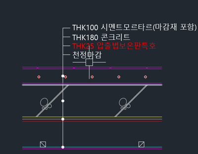

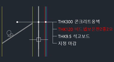

How should I draw a detailed view of the wall & slab part?
I will consider making the table on the right as a GDL Label later.
Of course, I plan to connect it with the right element.

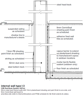

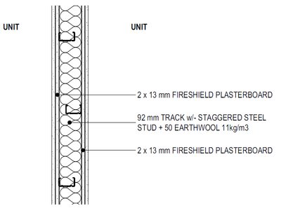

when you say "detailed view of the wall & slab" -- do you mean how to create wall type / slab type drawings?
because if it is, then you can do it using a zoomed in 1:5 plan drawing of a wall or 1:5 section drawing of a slab & adding notes/labels/lines etc on top of each wall/slab. you can even add objects that show where steel studs go.
or you can do it entirely in 2D where you can add more details such as how the walls/slabs connect to each other & other elements such as ceilings.
