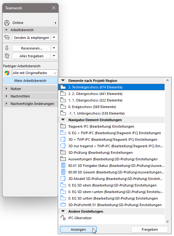

Stefan L_
Rockstar
@Barry Kelly  schrieb:
For text and dimensions, you can use Find & Select.
But you will need to open every view and run it in each one.
When you're in a Teamwork, you can (mis)-use the reservation dialog as an extended Find & Select:
- release all
- click "Reserve..."
- a dialog pops up where you can specify the same criterias but all and every view and layout and what not:
May take a while for AC to open every layout...
After that, you'll find the elements here:
