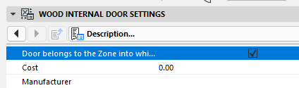

Here is the variable: "Door belongs to the Zone into which it opens"
Here, I can select it for inclusion in a door schedule:

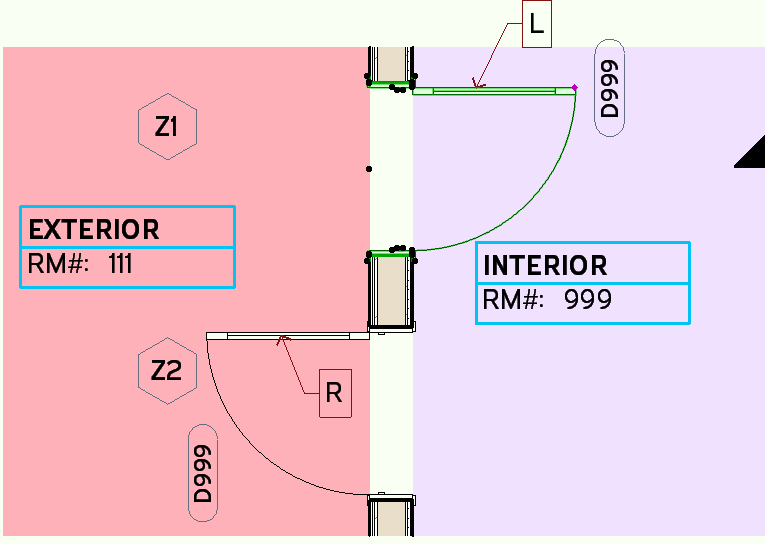

If the variable is TRUE, then the Exterior Room is not the zone into which it opens. If the variable is FALSE, then the Exterior Room is the zone into which it opens (i.e. the Exterior and Interior Room values will switch between the To Zone and From Zones depening on which zone the door belongs to. Here's an example:
Here, the doors would be scheduled as follows (the IDs are Z1 and Z2)
Z1: Door D999-1 -- Exterior-111 TO Interior-999
Z2: Door D999-2 -- Exterior-111 FROM Interior-999
Per Archicad, the "Exterior Room" for Z1 would be the FROM ZONE and for Z2 would be the TO ZONE. So, to get the proper zone listed as exterior or interior, I need the FROM/TO ZONES to switch. I can do this very easily if I can include the value of the gsb_OpeningToZone variable in a simple IFS expression.

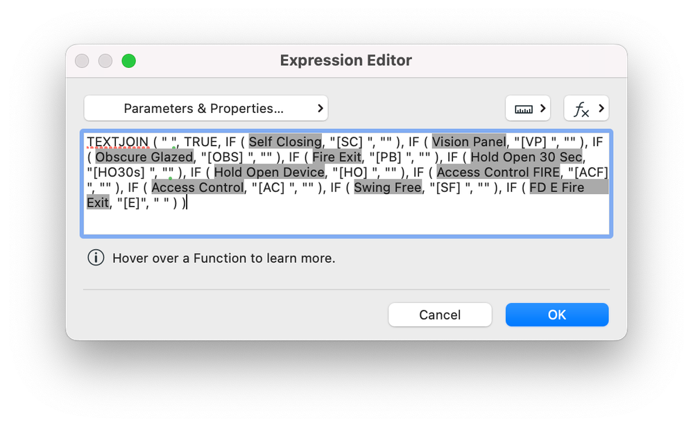

Right here you go. I have attached several screenshots. I have set up a series of Properties for Fire Door Labels where are all True/False options. I then wrote an expression which searches these Properties and displays one value if the Property is True and another if it is False. I have a secondary Expression which searches various options under the 'Openings' Properties and again displays various test depending on the True or False status. I hope this helps.
