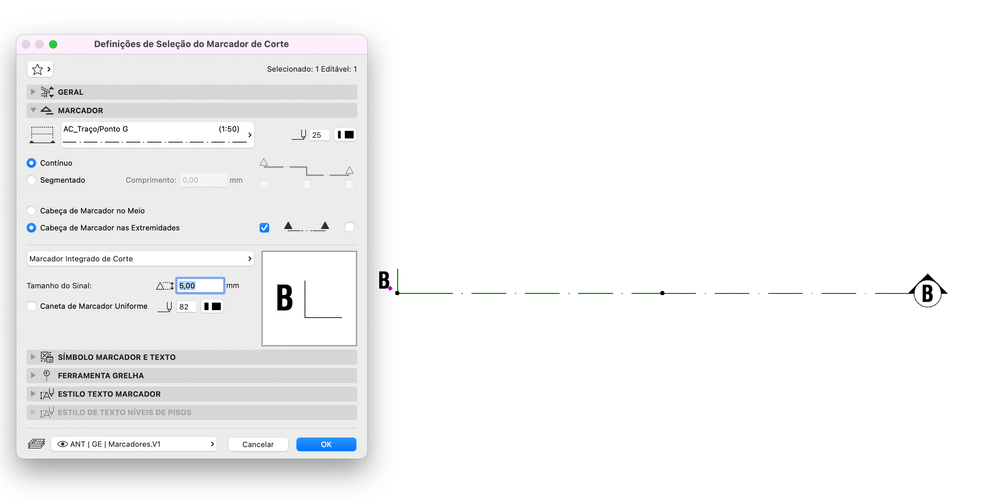

I want a section mark like this.

It's not possible with native tool. As a workaround, you could put the Original Marker in a floor that is not in any layout, and then you can put in the other floors, two markers with one end in opposite sides, and then associate (bound) to the main cut-marker.
Sorry for Brazilian print screen)Sorry for Brazilian print screen)
