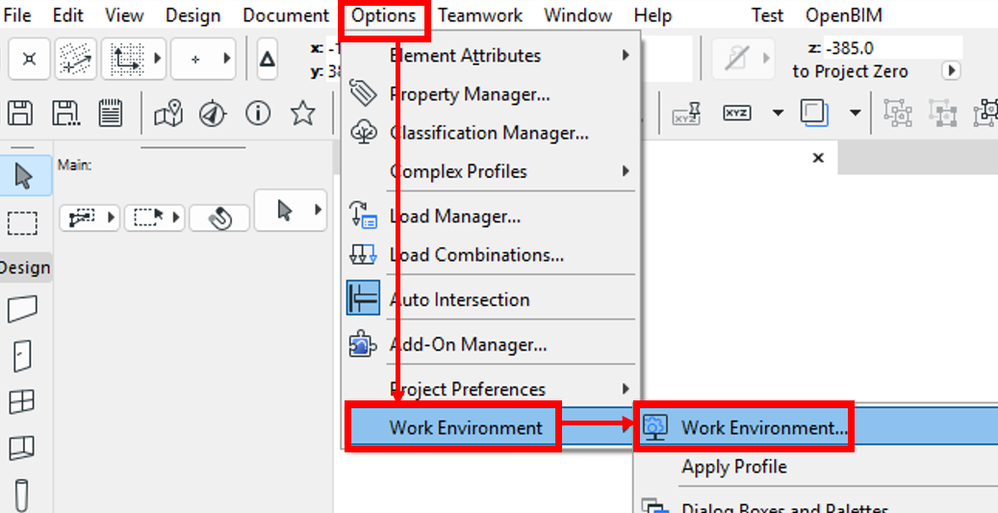

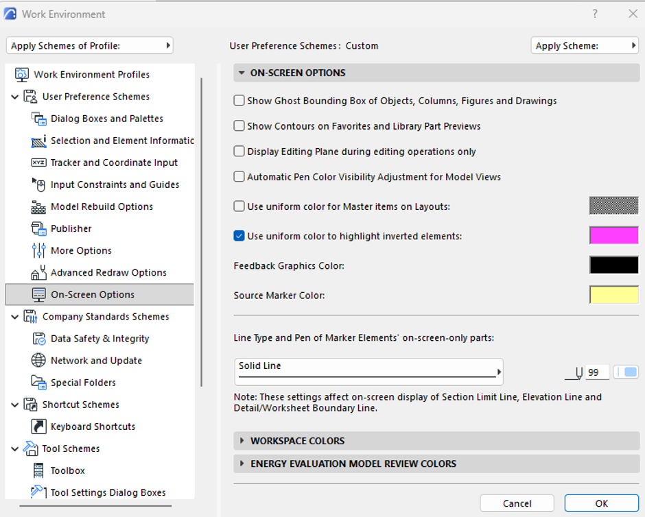

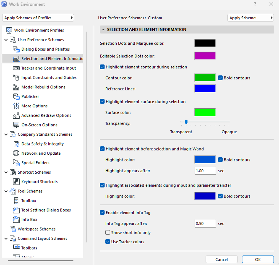

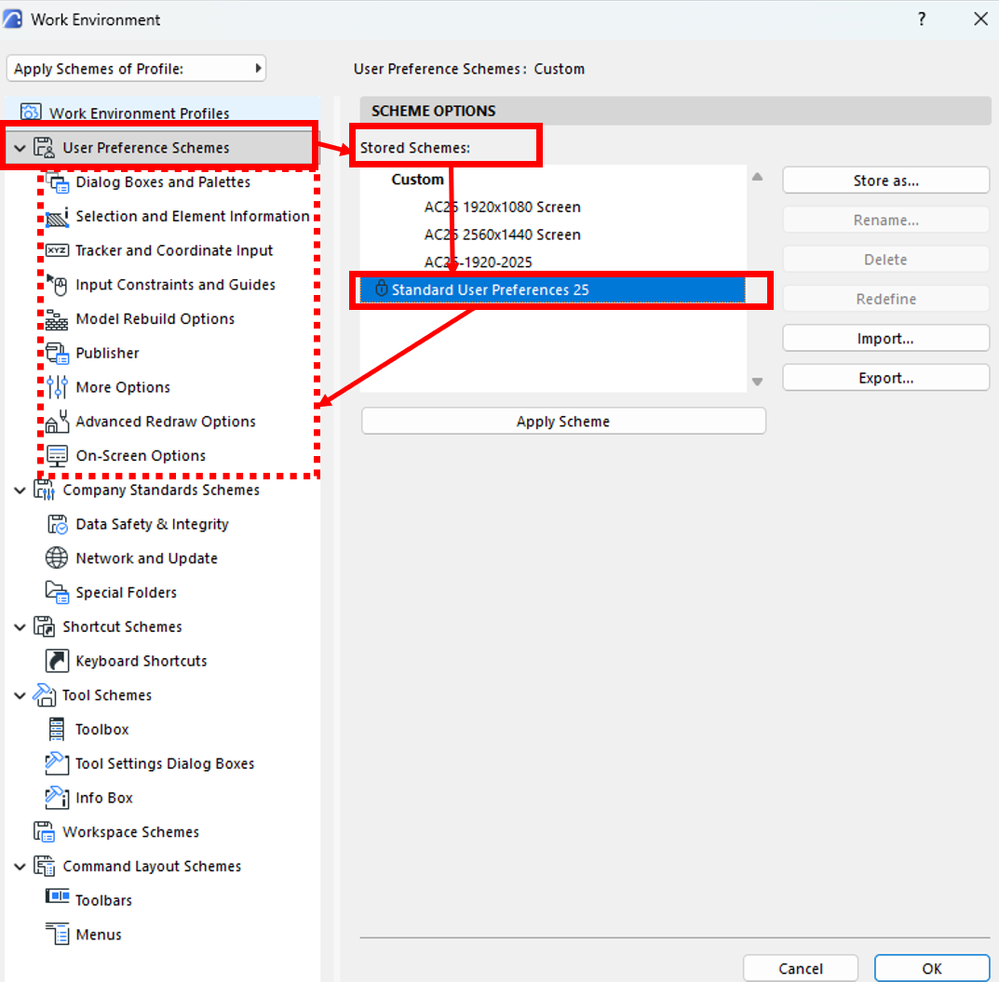

setting up your work environment:
go to menu Options->Work Environment -> Work Environment...

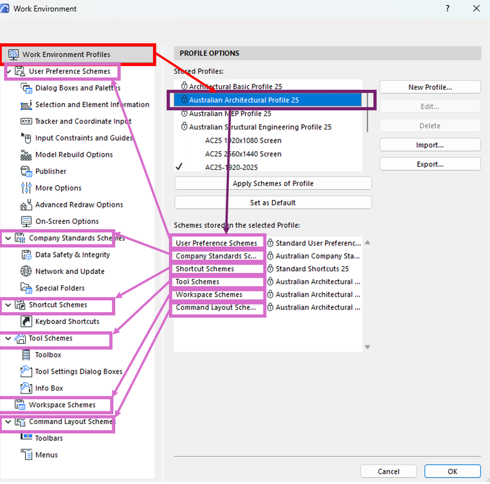

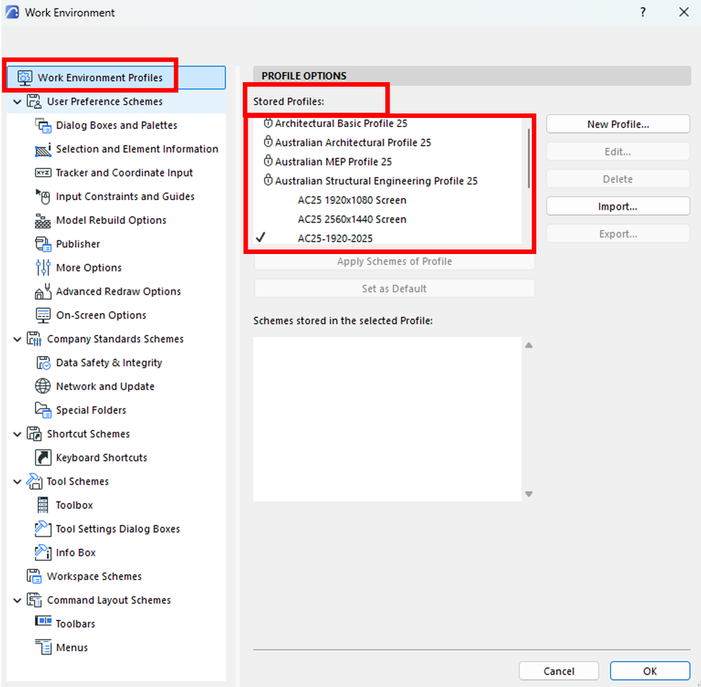

The top group of the list is the Combination of work Environment "Combinations" that you use

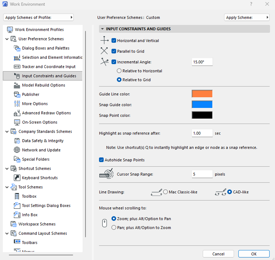

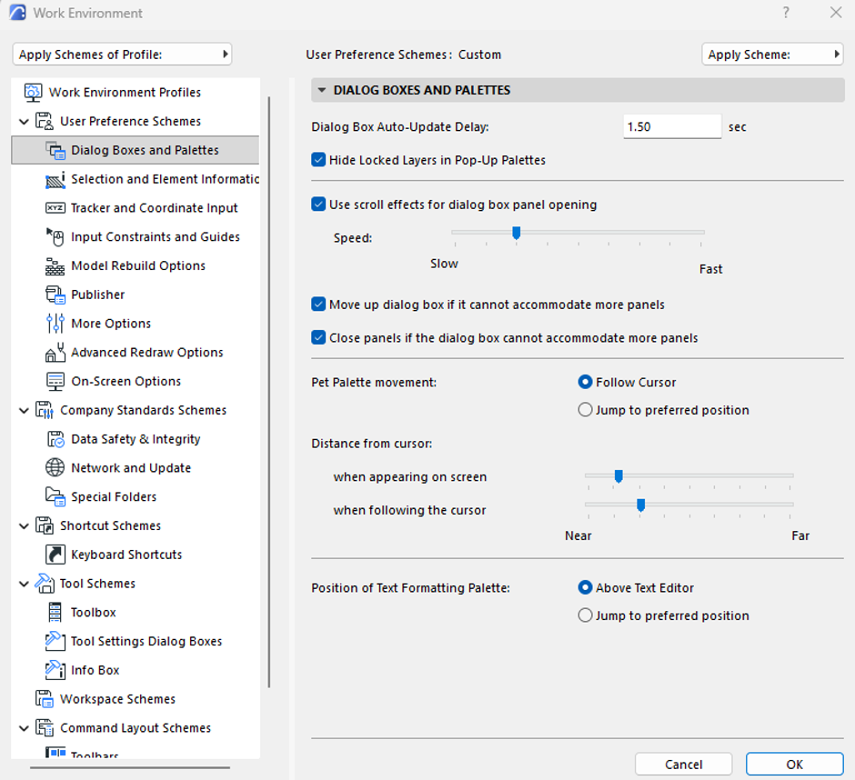

You can set up Custom Keyboard Shortcuts, data safety settings, onscreen display preferences, how the mouse works (click click or click and hold), screen gravity, custom tool bars, custom menus locations of open pallets, what pallets are open/closed when opening a file, etc.
you can save these preferences for each group of settings.
in my case, i have different pallet layouts for different screen sizes
i.e. when I have to do presentations of TV's in board rooms the screen often doesn't support bigger screen sizes, but i still need all the pallets in usable places when working.
The User preferences Schemes can be stored, and the stored scheme will remember all the sub items settings.
the user preferences are to do with display and interaction things.

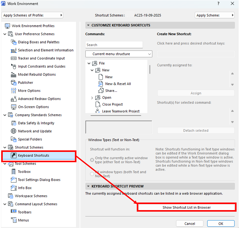

Shortcuts allow you to attach short cut keys to commands.
it also allows you to display all the current shortcut keys in a web browser.
This will include any shortcuts that you customize.
you can then copy the contents of you web browser output, and paste it into an excel spreadsheet.
then "fit to column" the spreadsheet, and you have a fixed record of you current keyboard shortcuts.
Tool scheme allows you to customize information displayed in toolbox, tool box info pallets, and tool settings dialogues.
Workspace Schemes remembers where you pallets, toolbars and the toolbox, etc.. are on screen, and which ones are open or closed.
Command Layout and Schemes allows you to customize what is in menus, and allows you to make custom toolbars.
