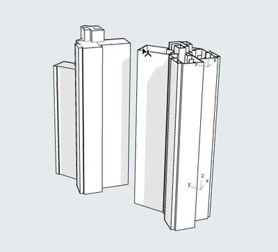

I want to create only the floor plan of building 1 from the floor plan of building 2. How do you do
How do you do it?
I'm trying to express the floor plan work, such as the dimensions of the building below.
To work on dimensions, etc., the above move overlaps with the dimensions, etc.
In REVIT, it works by copying the view and processing the Element on the upper layer as Hidden.
in ArchiCAD
After Hidden element in REVIT
What I can think of is to double the layer and make each copper layer, but in this way, it seems that the layer must increase in multiples whenever the number of copper increases
I'm curious to see how other people are handling it.

I am unclear, are these two separate buildings or are you doing a renovation where building 1 will become building 2?
If two separate buildings, model building 1 and then 'save as' building 2 and amend it (or the other way around).
Don't try to complete plans for 2 buildings in one file by using duplicate layers.
It can be done but could get messy.

It is a building with 101 buildings and 102 buildings and an underground parking lot.
Are you saying to create 101 and 102 buildings respectively and hotlink them to the file with the underground parking lot?
It is called a building floor plan, so each building draws a drawing at 1/200 scale.
AC27 on window 11
You seem to have both of these buildings in the one file already?
You can always create layouts and crop the drawing frames so you only see one building.
If I was modelling this then yes, I would have each building in a separate file and hotlink them into one master file for the overall project.
