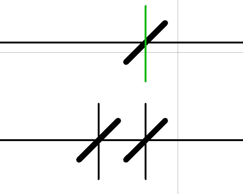

this part.. select it and delete and it will remove that point in the dim line
Yes this will remove that node but the dimension line will heal itself.
To break the dimension line you must select the exact centre on the dimension line of the dimension you want to delete.
This will remove that dimension and break what is left into two separate dimentions.

Deleting the whole dimension chain: select with the Mercedes
Deleting one dimension LINE - a part between the two witness lines: find the hotspot in the middle of that line, with the checkmark cursor. Select and delete
Removing an unwanted witness line: select with the chekmark cursor and delete
Moving/editing the dim text: find the handle at the lower left with the checkmark cursor, select, edit
Joining two dimension chains: with the Dim tool active, select one with Mercedes, CTRL click the other one
Rotating dim chains to position: select with Mercedes, rotate

To dynamically change the witness line, select the witness line at the intersection with the dimension line, then in the dimension tool click to set the end of the witness line. To change the witness lines of a section of the dimension string, repeat the process by first selecting the middle node. To change the witness lines of the entire dimension string, repeat the process by selecting the the edge of the dimension line using the mercedes cursor.
