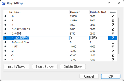

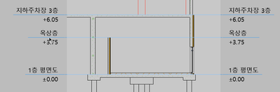

I want to subtract one Marker & Story Line from the cross section.
LeeJaeYoung
Except for just turning off the corresponding Story in the Story.
Another section uses this Story.

The Story Level Marker library part available in Archicad does not make it possible to specify the display of Story Level markers viewpoint by viewpoint.
However, there is a 3rd party library part called Indigo Figs Story Marker that can (but it is not free):
https://www.indigofigs.com/story-marker/
