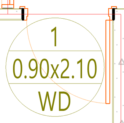

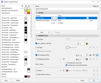

I would like to know how to select Graphic Override Combinations for door & window markers.
I want the marker to remain black.
AC27 on window 11

Currently GO only override the whole element.
You can automatically mask the marker with Model View Options.

Isn't it ON/OFF in MVO?

I asked this question because I wanted to keep the marker color as it is. The purpose is to exclude from being grayed out, not asking about disappearing.

As said before You can only override the whole element so it's actually impossible to grayed out the door symbol without the marker.
Use the Label Tool to create your marker and deactivate the door marker, this way you will be able to achieve what you want.

I have grayed it out.
LINE Pline TEXT Wall... grayed out one by one.
Thank you for your answer.
