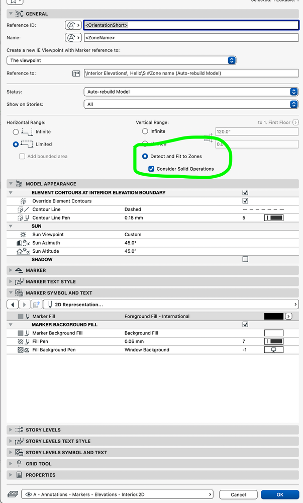

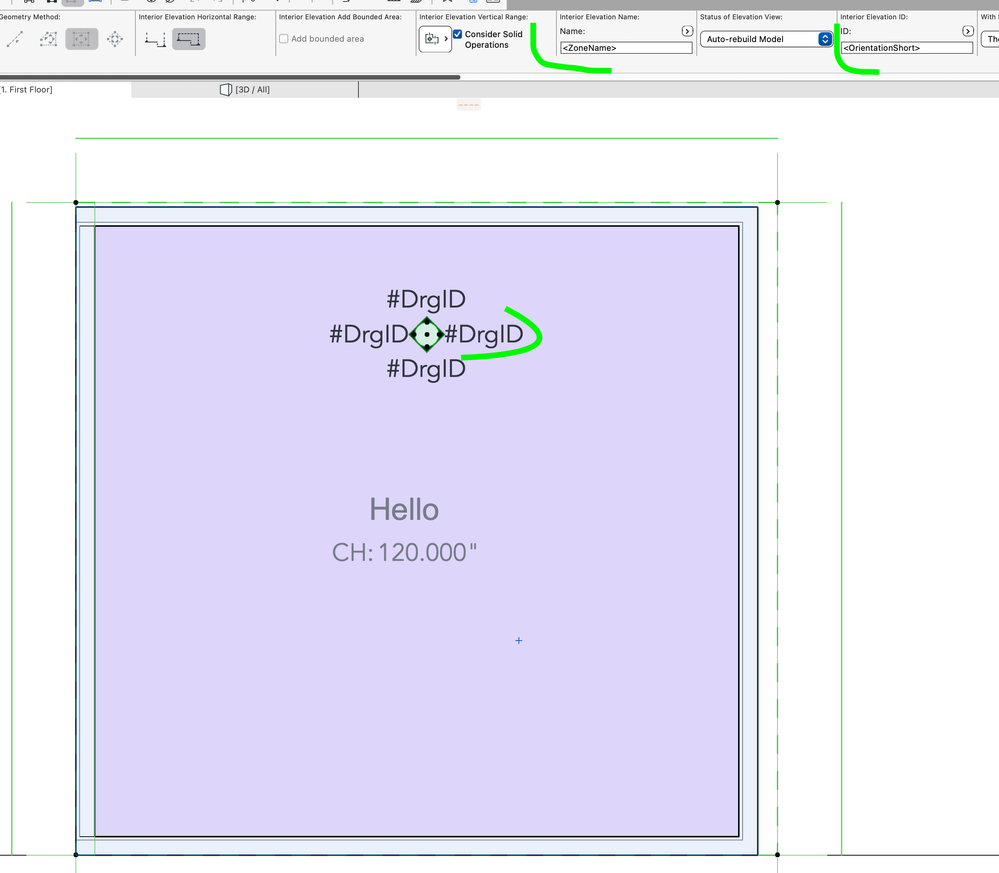

As we are working in new archicad 28 file, I have an issue with adding interior elevations and its id.
I have created test zone and set parameters that the interior elevations show name of zone in the middle and show Short Orientation.
The result is that it does not show neither elevation name, but also short elevation. I am ok not showing the name and not be connected with zone, but the short orientation should be respected. I opened other older file we had and it's working ok.
Instead of showing short orientation, it shows "drgID".
Does anyone know how to fix this?

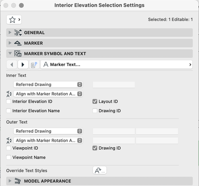

cocoloco:
Look at this part of the dialog box:
 This is for Common IE Marker 1.

cocoloco:

Unfortunately it is not corresponding with the zone, at all so even If I allow layout id, and drawing id, nothing shows. and the short elevations are not still showing either 😞

Solution
actually it was clicking on "viewpoint id" !
